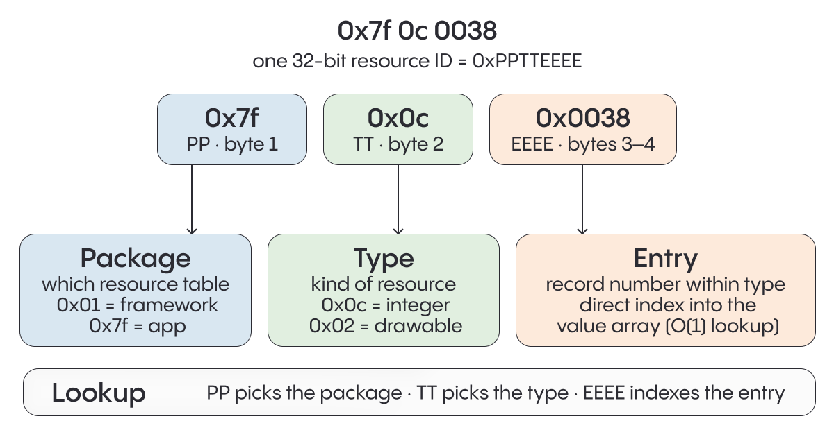

Because aloha-core is built simply as android_webview.apk, after aapt2 (Android Asset Packaging Tool) the resources will have IDs in this format:
Android resource ID split into package, type, and entry bytes
The package byte is the part that can change when the host application links the engine's resources.
The host app runs its own aapt2 to build its APK. Its resource merger throws everything into one pile: the app's own resources + appcompat + material + ... + our res/ from the AAR. Then link numbers it all together - sequentially, in merge order. min_screen_width_bucket, which got 0x7f0c0008 in the Chromium build, ends up as, say, 0x7f0c0038 in the host's table: the type is still the same - 0c (integer)-, but the entry and the ordering within the type changed, because there are now thousands of foreign records next to it.
However, the bytecode remains unaware of these changes and still references resources using the outdated identifiers. To resolve this, we needed a method to substitute the class's fields with the correct values during runtime.

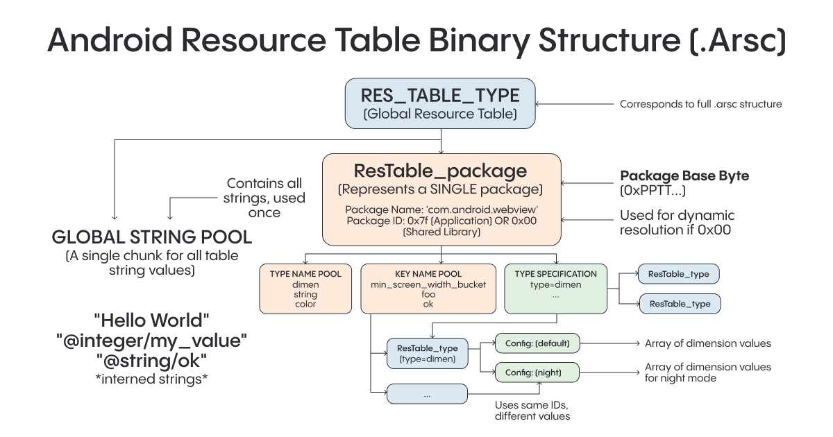

Attempt #1 — shared library (package id 0x00)
The first idea was straightforward. It all starts with building resources.arsc - we do it with the --shared-lib flag.A reminder: a value inside .arsc is always a Res_value structure, not a bare number. It records "what type I am" and "my data". A reference to another resource is a special case: type TYPE_REFERENCE, with the target ID in the data. The file is split into chunks. The chunks are nested; the hierarchy looks like this (simplified but essentially accurate):
Diagram of a binary Android resource table and the package ID used by a shared library
A shared resource table leaves its package base open for runtime assignment.
ResTable_package is the "resource book of one package". It has a .id field - that top byte, the "package base". This is exactly what --shared-lib zeroes out. In a normal APK it's 0x7f; in a shared-lib it's 0x00.An ID is laid out as 0xPPTTEEEE, which is why lookup is O(1):
  • PP (package) → pick the right ResTable_package (by matching .id);
  • TT (type) → pick the right ResTable_type (of the right type and the current configuration);
  • EEEE (entry) → this is a direct index into the value array inside ResTable_type.
All we need is to correctly control PP.
What --shared-lib gives you
Here's what --shared-lib gave us:ResTable_package.id = 0x00. In a normal APK it's 0x7f. 0x00 is an agreed-upon marker: "base not assigned, it'll be assigned at load time". By itself it "does" nothing - it's a signal for the loader.All internal references are written with a top byte of 0x00. This is needed because a table can contain values that reference another resource within the same table. That's a Res_value of type TYPE_REFERENCE, and its data holds the full target ID - all four bytes 0xPPTTEEEE. In a normal 0x7f-APK the linker would write 0x7f, since the target lives in the same 0x7f package. And that's exactly why such an APK is non-relocatable: its internal references are nailed down to the 0x7f base; load it into a process where it would get a different base, and the references would point into a foreign package.--shared-lib writes 0x00 into these references instead of 0x7f. The meaning of a 0x00 byte in a reference is: "the target is inside me, in this same library, and whatever my base turns out to be is unknown at build time — substitute it at read time". So the references become position-independent too. That's why in the file they stay 0x00 forever, and 0x02 only appears at resolve time.
A RES_TABLE_LIBRARY chunk is added — the "dynamic library export table":

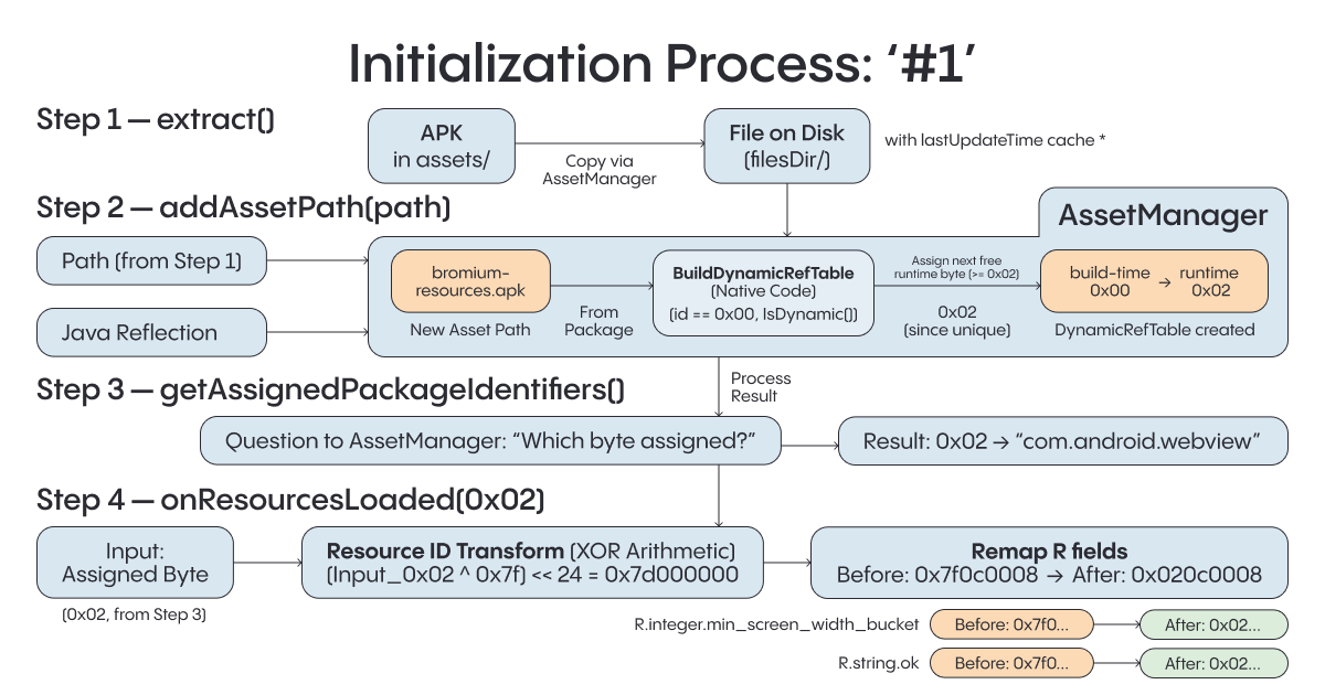

Runtime: four steps
Next we put bromium_webview_apk.ap_ (~1.3 MB) into our AAR under assets/ with the name bromium-resources.apk. During the build the host neither unpacks nor touches it - it just carries it as-is in assets/. All work with the table happens at runtime.
Step 1 - extract(). The APK sits inside assets/, but the resource loader can only work with a file on disk. So we copy bromium-resources.apk from assets/ to filesDir, cached by lastUpdateTime (the second launch skips the copy).
Step 2 - addAssetPath(path) via reflection adds our table to the AssetManager. At exactly that moment, inside native code, BuildDynamicRefTable fires: the loader sees our package (id == 0x00, flagged IsDynamic() because of RES_TABLE_LIBRARY) and assigns it the next free runtime byte, starting from 0x02. Our dynamic package is the only one → it gets 0x02. Right there a DynamicRefTable is set up with the entry "build-time 0x00 → runtime 0x02".
Step 3 - getAssignedPackageIdentifiers(). We ask the AssetManager: which byte did you hand us? It answers 0x2 -> com.android.webview.
Step 4 - onResourcesLoaded(0x02). We rewrite all the fields of the R class. Recall the arithmetic laid out earlier: the fields are baked with 0x7f, the transform is (0x02 ^ 0x7f) << 24 = 0x7d000000, and we apply XOR to every field - 0x7f0c0008 ^ 0x7d000000 = 0x020c0008. Compiled arithmetic, no strings and no reflection - the whole step is ~2 ms.
Note the asymmetry - it's what decides everything in a moment. The R fields are one per process: they're rewritten exactly once (guarded by the sResourcesDidLoad flag) and to a single base. The DynamicRefTable, however, is separate in each AssetManager. The first is global, the second is per-namespace. In attempt #1, these two drift apart, and that's exactly where it breaks.
After launch, a check, and everything works. Or so it seemed to us.

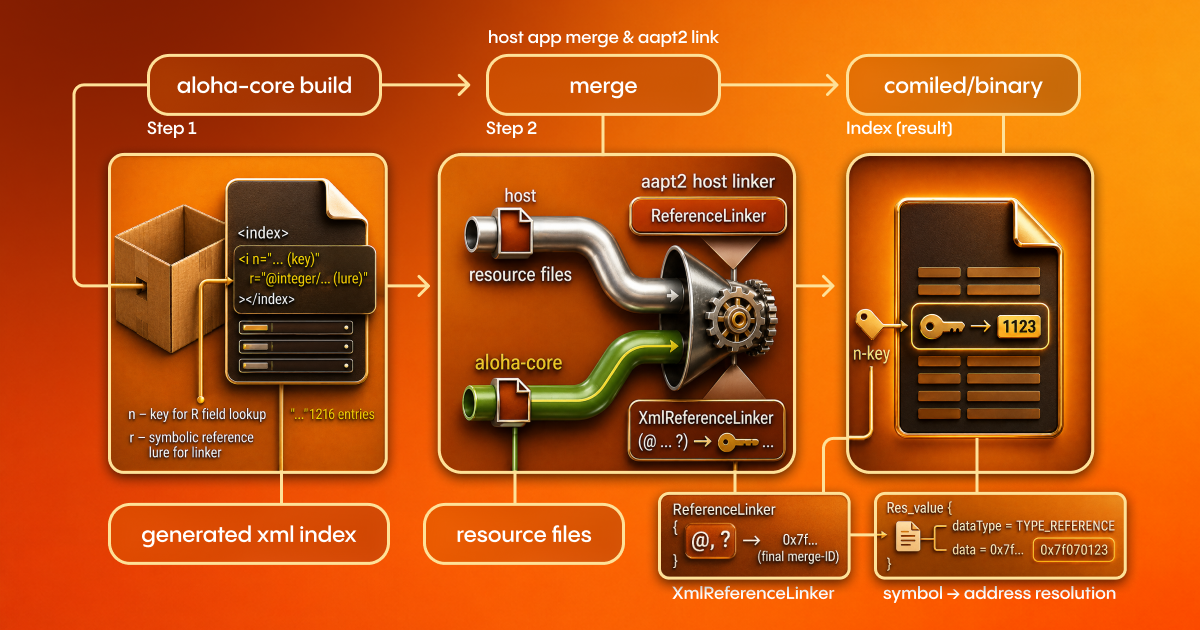

Piggybacking on the host's aapt2
Here's what we know: the host's aapt2 already turns every name into a final ID. It does this for any @-reference in any layout - that's its regular job, a single pass at build time, with indexes and no runtime cost. So let's slip it a file that references all our resources and pick up the finished numbers at runtime. We're not speeding up the name lookup - we're moving it to the host's build stage, where it already happens for free.
Step 1.
At build time, we generate an index and place a file res/xml/bromium_res_index.xml into the shipped res/:
xml
<index><i n="integer/min_screen_width_bucket" r="@integer/min_screen_width_bucket"/><i n="attr/select_dialog_multichoice" r="?attr/select_dialog_multichoice"/>
... <!– 1216 entries --></index>
  • n - the key: the R field name in type/name form (integer/min_screen_width_bucket). This is what we'll look up later when rewriting. (For styleables, the R field is called Foo_Bar while the resource is Foo.Bar; that's accounted for.)
  • r - a reference to the real resource by its real name. Usually an @-reference (@integer/...), but sometimes ?attr/... - we'll come back to this difference in step 3. This is the bait for the host's linker.
Step 2 (the host's aapt2) - the linker stamps the final IDs into the index.
The host builds the app, its resource merger merges our res/ with its own, and aapt2 link compiles everything, including our bromium_res_index.xml, into binary AXML. And here's the interesting part. When aapt2 compiles the XML, the attribute r="@integer/min_screen_width_bucket" stops being a string. In binary AXML an attribute value is stored as Res_value{size, dataType, data}. And @integer/... compiles into dataType = TYPE_REFERENCE, with the final merged ID of that resource placed into data. The passes that are literally named this way in the aapt2 sources - ReferenceLinker / XmlReferenceLinker - resolve every symbolic type/name reference against the symbol table of the merged resources and stamp in the number. Exactly like a static linker: symbol → address. So after the host's build, inside the compiled bromium_res_index.xml, each entry holds: n = "integer/min_screen_width_bucket" (the string key) and r = Res_value{TYPE_REFERENCE, data = 0x7f070123} (the correct host ID).
Diagram showing AAPT2 merging resources and stamping final IDs into a compiled XML index
The host link step resolves each symbolic resource reference and writes the final ID into the compiled XML index.
Step 3 (engine initialization) - AlohaCoreResources.init() rewrites the R fields.
  1. One! getIdentifier("bromium_res_index", "xml", pkg) - the single name lookup in the whole remapping. The same expensive one that used to be called 2450 times.
  2. res.getXml(id)XmlResourceParser on top of the native ResXMLParser. Critically: the AXML blob is mmap'd from the APK and traversed in place - this is not text parsing, but a walk over a ready binary structure with interned strings.
  3. For each entry, getAttributeResourceValue(null, "r", 0) - takes Res_value.data of the r attribute straight from the mmap'd blob; a TYPE_REFERENCE is returned as a number. Zero lookups into the resource table - we don't resolve the resource, we read the ID already stamped into the attribute. We put it into a HashMap<"type/name", id>. A special case is the ?attr/... entries: they compile not into TYPE_REFERENCE but into TYPE_ATTRIBUTE, and getAttributeResourceValue returns a default for them. For those we use getAttributeValue, get a string of the form "?<decimal id>", and parse it. A minor fork that doesn't change the essence.
  4. Reflection - we rewrite the R fields. For each type: Class.forName("org.chromium.ui.R$string").getSuperclass() yields gen.base_module.R$string (per-library R classes are empty subclasses of a common base where the fields are declared once), then field.setInt(null, id).
The runtime total: one getIdentifier + a linear scan over the mmap'd blob + reflection (which was in the original too). ~12 ms.
